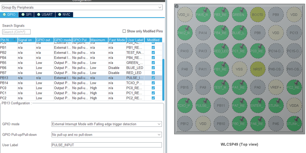

The code I wrote for the B-L072Z-LRWAN1 is supposed to count pulses on a falling-edge external interrupt pin. The pulse source is an Arduino which toggles its GPIO on and off every 5ms, for a 10ms pulse period. after 6 seconds, the B-L072Z-LRWAN1 transmits the accumulated pulses to a receiving B-L072Z-LRWAN1 device (using proprietary peer-to-peer communication [confirmed to work properly]), which after 6 seconds should receive a count of 600 pulses. The 6 second timer has been confirmed to trigger a callback every 6 seconds.
My issue is that only 300 pulses are being send, which implies that the interrupt is only being called or incrementing every other time. There is an IoT bridge which takes the pulse input from both the arduino and the receiving STM32 device, and displays the pulse count on an IoT platform. the graph shows that the pulse rate for the STM32 is exactly half of what is coming from the Arduino. After debugging, I confirmed that the sending device is sending the wrong number of 300 pulses. Can anyone tell me the reason for this?
Here is a screenshot of the gpio configuration:
here is the cubeMX configuration function:

  GPIO_InitStruct.Pin = PULSE_INPUT_Pin;
  GPIO_InitStruct.Mode = GPIO_MODE_IT_FALLING;
  HAL_GPIO_Init(PULSE_INPUT_GPIO_Port, &GPIO_InitStruct);

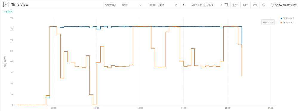

And here is what is showing up on the IoT platform. Sometimes the controller sends the correct 600 pulses, and sometimes it sends 300. The units are not important, as this is only to show if the number of pulses sent match what is sent from the arduino or not. the dip at 11:00 is just from me disconnecting the receiving device for a few minutes.

Yes, the independent pulse count is the blue line in the last screenshot
So I measured the pulse input on an oscilloscope, and it's about as clean of a square wave as one can get. It's coming from a digital output device, anyway. I thought switch bouncing was the result of physical switches.

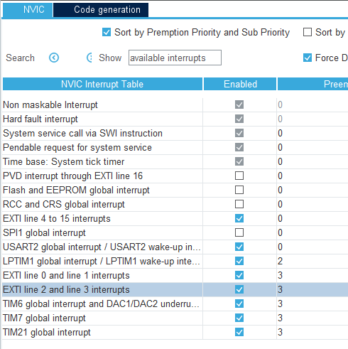

lptim has a 1 second period where sTxDelay = 6, the TEST_RANGE_Pin [PB2] is never triggered in this case, and DIO0 [PB4] only goes high if a transmission has been received, which is every 6 seconds, which is a response from the receiving device to verify the sending device's transmission. But to test your hypothesis, I set the interrupt lines to the following:
Unfortunately, I am still only getting half the amount of pulses.
