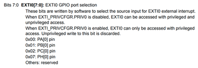

If I register a callback function for GPIO EXTI and I have EXTI on multiple ports for the same pin (e.g. PA0 and PB0) how does the callback distinguish between the ports when the event triggers?

You can't have EXTI enabled on the same pin number of multiple ports. It's a hardware limitation.
