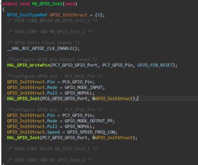

I just create a basic iOC file that,
Select these inputs for FSBL according to the figure.
But for the MX_GPIO_Init there is only PC7 and PC6 pins initialized. I can not see UCPD1_CC1 and UCPD1_CC2 pins.

Hi again @Clyasenth
In my understanding, as referenced in datasheet, the function during and after reset is the same as the actual pin name. So, they could not be reused as GPIO.

Hello @FBL
Is there any bug or something in Cube MX or Cube IDE because, I can chose UCPD1_CC1 and UCPD1_CC2 pins as GPIO in Cube MX and Cube IDE.
