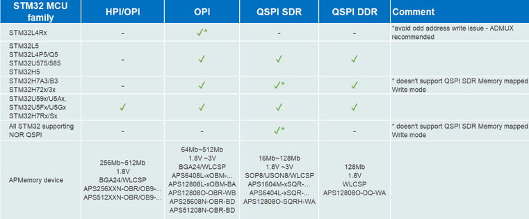

Edit: seems like I made this too soon. It looks like memory mapped writes are simply not fully supported on the H723 with AP memory. Okay, that's that. Weird for STM32 to have an "AP Memory" setting if that's the case.
The more I read into troubles and erratas it feels like the OCTOSPI interface is quite half-baked on the STM32H7. Maybe newer families are better.
‎2024-10-01 11:25 AM
Yes, there are a documented limitation for supporting Quad SPI SDR memorry mapped write on STM32H723. OCTAL SPI Memory controller is full spec. Newer MCU have this QSPI limitation solved.

Adding few comments, if pin count is most critical we do have 128Mb QSPI DDR supported by STM32H72x/3x, improving BW at low pin count but this is WLCSP, so not most easy to assy.
Regarding Octal RAM all density (64Mb ~512Mb) can be supporting in BGA24.
Overview below:
