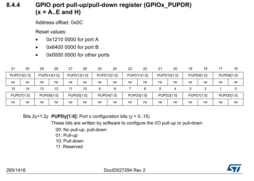

Posted on April 05, 2018 at 11:56
you should check it.. this is the wrong reference manual for that chip.
Posted on April 05, 2018 at 12:08
I think in your example PB1 has pull-up nor PB4, if I read the datasheet correctly. For my MCU:
It would seem that:
PB15 is pulled up
PB 14 is pulled down
PB 13 is pulled up.
Posted on April 05, 2018 at 12:18
That's how I read it too,   (it was PB4 pulled, up, hard to read,)
check the errata on the chip, maybe someone from  ST can answer you ???
if you have any product volume, the FAE will respond, did you try him ?
