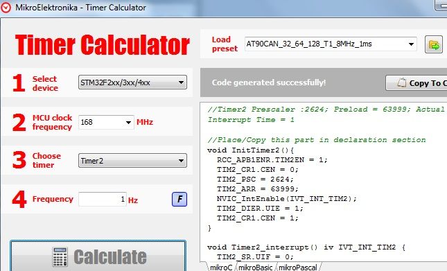

i am trying to generate 1Hz of pwm, this is the code for the same
void TIM1_Configuration(void)
  TIM_OCInitTypeDef  TIM_OCInitStructure;
  TIM_TimeBaseInitTypeDef  TIM_TimeBaseStructure;
  uint16_t Period;
  Period = (SystemCoreClock / 1000000);
  /* Time base configuration */
  TIM_TimeBaseStructure.TIM_Prescaler = 2624;//0; // Dump 1X clock into timer
  TIM_TimeBaseStructure.TIM_Period = 63999;// Period - 1;
  TIM_TimeBaseStructure.TIM_ClockDivision = 0;
  TIM_TimeBaseStructure.TIM_RepetitionCounter = 0;
  TIM_TimeBaseStructure.TIM_CounterMode = TIM_CounterMode_Up;
  TIM_TimeBaseInit(TIM1, &TIM_TimeBaseStructure);
  /* Enable TIM1 Preload register on ARR */
  TIM_ARRPreloadConfig(TIM1, ENABLE);
  /* TIM PWM1 Mode configuration */
  TIM_OCInitStructure.TIM_OCMode = TIM_OCMode_PWM1;
  TIM_OCInitStructure.TIM_OutputState = TIM_OutputState_Enable;
  TIM_OCInitStructure.TIM_Pulse = ( TIM_TimeBaseStructure.TIM_Period +1)/ 2; // 50%
  TIM_OCInitStructure.TIM_OCPolarity = TIM_OCPolarity_High;
  /* Output Compare PWM1 Mode configuration: Channel1 PA.08 */
  TIM_OC1Init(TIM1, &TIM_OCInitStructure);
  TIM_OC1PreloadConfig(TIM1, TIM_OCPreload_Enable);
  /* TIM1 Main Output Enable */
  TIM_CtrlPWMOutputs(TIM1, ENABLE);
  /* TIM1 enable counter */
  TIM_Cmd(TIM1, ENABLE);
but 1Hz I am not getting(no digital waveform, sinusoidal wave), I generated the values from the MikroElectronika Calculator tool.
Posted on March 17, 2015 at 15:32
Ok, it helps to understand what you're doing rather than use tools that hide the detail.
Your system file suggests the timer is clocking at 64 MHz, not 168 MHz
To get 1 Hz you need to count 64000000 ticks at 64 MHz. A simple factoring of this gives
1000 x 64000
So
Prescaler = 1000 - 1;
Period = 64000 - 1;
Pulse = 64000 / 2; // Half of the Period
