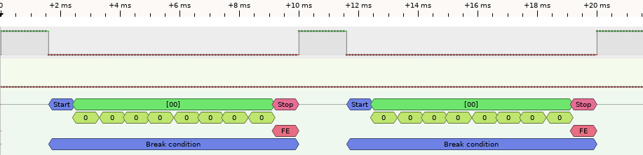

As a naive experiment I tried continuously sending break upon a completed transmission.
void USART1_IRQHandler(void) {
if (Port->SR & USART_SR_TXE) {
// Enable interrupt on completed transmission
Port->CR1 |= USART_CR1_TCIE;
// Generate a break signal
Port->CR1 |= USART_CR1_SBK;
This gave me this output in my logic analyzer (the uart is running at 1200 baud): In between the breaks, there some time where the line goes idle (or are those stop bits generated by the break itself?).
Any suggestions on how to drive the TX line low for more than one character (M) width?

‎2018-11-15 11:18 PM
I understand your task, but customarily, on RS232, *any* MARK longer than start+data(+parity) bits is considered BREAK, so ST's approach is legitimate. In other words, it's your application which requires a non-standard BREAK, so you need to generate it "manually", by setting the pin to output.
> But then what is the time needed for the uart to stabilize when I re-enable it?
You'll switch only the Tx, so none.
More precisely, you need no time to *stabilize* UART, but you'd need some time (probably one bit's time) between the break trailing end and the first startbit for the UART on the other end to be able to distinguish them.
