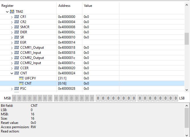

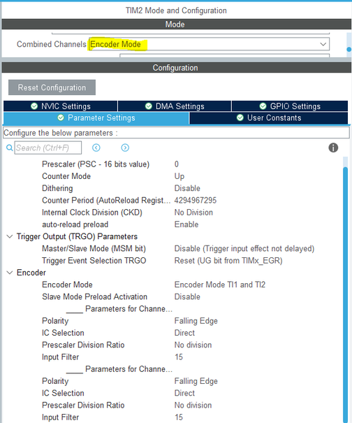

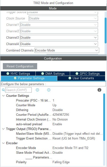

I am attempting to set up an encoder on STM32G431RB using Tim 2 which is 32bit but it is only counting up to a 16bit value and going negative. I looked at the register through SFR and only the first 16 bits are active, is there another setting I need to change to use the full 32 bits? SFRSFRConfigConfig

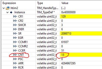

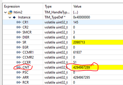

I just tested on the same Nucleo-G431RB and I can get the TIM2->CNT to show 32 bit values. There was nothing special needed to be done.
When i turn the encoder clockwise, you can see that CNT goes up starting from zero state.
And when I turn the encoder in reverse it is in the 32 bit values

waclawek.jan
How do you observe that, exactly?
Your screenshot of regsiters does not indicate this; I see all zeros there.
Show us a screenshot which demonstrates that only 16 bits of TIM2_CNT are active.
OK now I see why, the IDE probably does not have capability to display both variants of the register layout (for DITHEN = 0 and DITHEN = 1, see TIMx auto-reload register (TIMx_ARR)(x = 2, 5) in RM) so it resorted to an entirely incorrect way to display it as a 16 bits and a 1 bit field. This may be CubeIDE's limitation/flaw; so, as @Karl Yamashita said above, you may want to look at TIMx_CNT through the variable view in this particular case.
