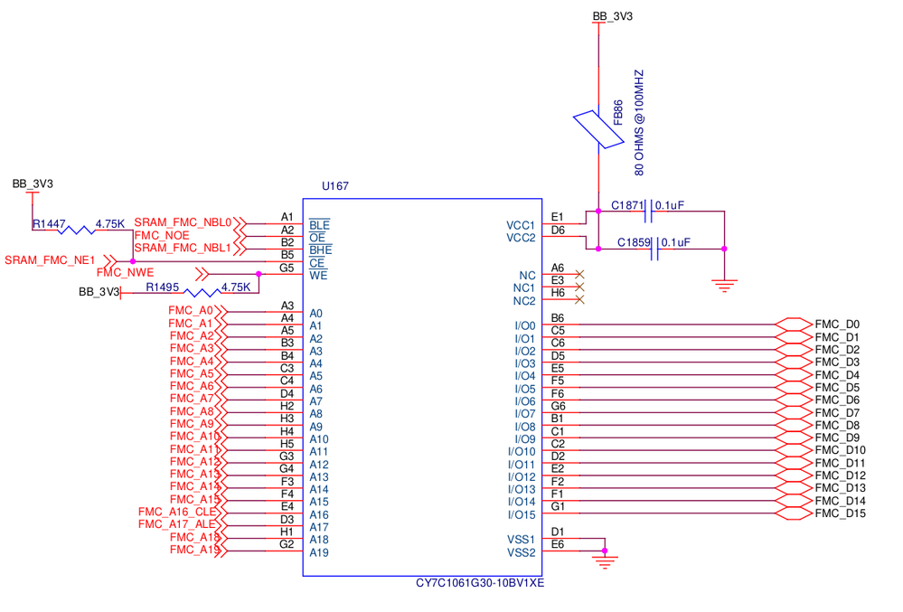

We have been using two SRAMs (CY7C1061G30-10BV1XE) & one NAND Flash(MT29F8G08ADAFAH4-AAT) interfaced with STM32L562 micro-controller on same FMC bus. We have initialised FMC and try to access SRAM1 by selecting Chip select: NE1 and Bank 1. It is being observed that there is mismatch between Read and Write Data in Bank 1 (FMC Base address: 0x60000000). Also, we have tried to change the various parameters' values as configurable under FMC Initialisation (like: Byte Lane NBL set-up timing and other SRAM timing parameters), but this all could not help us and data mismatch persists. Also, we suspect that FMC clock frequency which is set as 25MHz in our case.
Schematic of SRAM, our code and FMC initialisation can be referred below:

2 REPLIES 2
KDJEM.1
Hello @ashutoshtekriwal ,
This issue may be due to a wrong timing configuration, for that I advise you to refer to AN4761 precisely Timing computation section.
I hope this help you.
Kaouthar
ashutoshtekriwal
We have already gone through AN4761 and timing seems to be correct, we have also tried with increased timings and low clock frequency but nothing works as of now. Kindly suggest some way to debug that timings are fine/correct.
