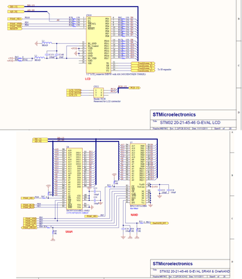

Thank you, so FMC_NEX works in parallel with another enable? Do I have to stop refreshing the display when I want to modify something in the buffer? Additionally, will this solution work OK and does double buffer make sense in this case?
Each enable is activated at a time. FMC_NEx is activated automatically by the FMC controller according to the description I provided previously.
As example, you can refer to the STM3240G-EVAL board schematics which is using LCD and SRAM that both are connected on FMC interface:
You are using LCD over FMC, and normally, these kind of display devices have their own controllers with an internal RAM that holds the display buffer. I don't think you need to stop refreshing the display.
