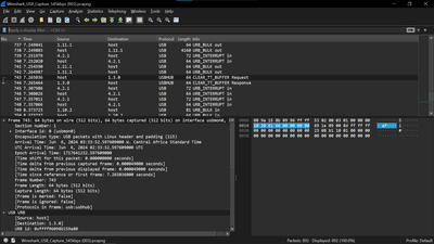

7. Since dd achieves good OUT throughput, I looked at what's going on the USB bus using wireshark
(which can anazlyze USB traffic at the URB level). What I saw is that here too, a few pending
IN transfers are initiated at the start of the application and never complete. even though dd
transfers data in strictly one direction. So there must be something about this that's required

June 6, 2024
Hello @FBL,
See attached 7z file. Your forum for some reason believes that zip files are a security risk, but rar and 7zip are not. Crazy.
I can't tell you what's happening on the wire, but the two wireshark capture files therein show you what's happening at the URB level (and their timestamps). There's not much to see. One of them (the fast one) has an IN URB submitted at the start of the communications, and the other - doesn't. This small difference causes throughput for one case (with IN request) to be 950kpbs  but only 545kbps for the other version (no IN request) .
Both captures are of a small libusb based host-side application I adapted from some online code, which runs in libusb async mode (if you're familiar). Essentially, I have an API call which sends an IN request before starting the HOST->DEVICE continuous transmission. I can comment out the line or not, and this causes the difference.
The "fast" version overall corresponds to what wireshark captures when I use dd to send data to the device. for some reason, dd also submits a phantom IN request before starting. I've searched high and low, and asked on the libusb mailing list, and found no evidence that the USB spec requires this odd behavior.
I did these test on an old linux box which has an ICH9 controller. The STM32 code is just the basic code generated one (as far as I can remember).  main is just an empty loop. Here is the callback code. As you can see the receive callback does nothing but acknowledge the packet. If I recall correctly, the transmt calback never gets called anyway (since my firmware never sends anything).

Hi @BarryWhit
> when there are no IN transfers pending, please let me know. Is it a USB spec requirements?
 IN transfers (device to host) should not impact OUT transfers (host to device) in terms of functionality
If you are not using transmitting data or status information back to the host, you might be considering disabling the IN direction (disable the TX).

June 28, 2024
But@BarryWhit USB is half duplex, it achieves bidirectional communication over the single differential pair by switching between sending and receiving data, but it cannot do both simultaneously.
When you are referring to having a pending IN transfer to achieve good OUT throughput is confusing. Maybe there is something else I'm missing.

Pavel A.
June 28, 2024
Pending IN transfer will cause the host controller to poll the device almost continuously (or once in N ms if the IN endpoint is interrupt). This obviously can cause difference in behavior of the firmware. Need to use the analyzer to understand details. It is not clear how the dd can activate IN request, it is basically a wrapper for "write" syscall, not aware of USB. There are production quality USB libraries and drivers for STM32, for best results and decent support you may want to use them. The best feature of the Cube "middleware" is the price.
