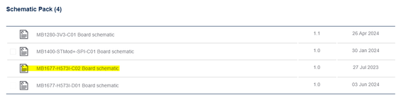

All STM32H573I-DK documentations are available here.
Also you can find the schematic for STM32H573I-C02 board in CAD Resources.

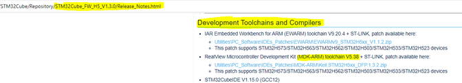

Hi @rchilakalapudi ,
Could you please update you Keil toolchain version.
The development toolchain for STM32Cube_FW_H5_V1.3.0 cube firmware is MDK-ARM 5.38 as mentioned in release notes.
Thank you.

‎2024-08-12 3:29 AM - edited ‎2024-08-12 3:30 AM
The STM32H5 MCU is a new product which may not be supported by this older version of keil.
To solve your issue I advise you to use STM32CubeIDE toolchain.
