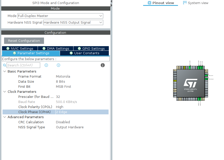

Here are the SPI configurations:
Prescale to 32 to have a baud rate of 500Kbit/s (Maximum frequecny at 1Mhz) / CPOL to High /Clock Phase: 2 Edge.

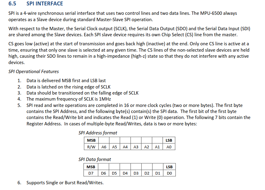

Here are the characteristics of the MPU6500 :

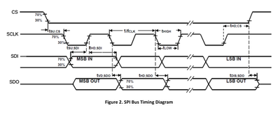

It was just the NSS signal. If i try to do with a "HAL_GPIO_WritePin" to drive NSS signal it's works.
Did you know why?
You're not doing anything with CS. Bring CS low before the start of the transaction and high afterwards. Initialize it and control it as a GPIO output pin.
I would also guess the data registers are meant to be read in one single transaction. If you read 6 bytes from 0x3B, you will get addressed 0x3B, 0x3C, 0x3D, etc...
Thanks.
What is the point of putting NSS on an NSS physical pin in the CubeMX configuration?
Unless I'm mistaken, that's already the case, isn't it? In this example I read the registers in a single transaction, right?
In master mode SPI on the STM32F4, the NSS pin output is low, always. It does not toggle at the start and end of transactions.
