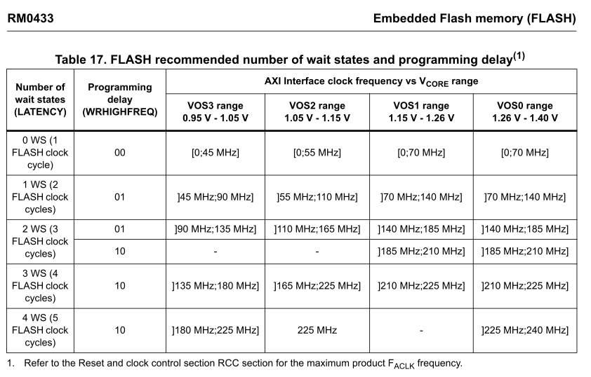

Today while looking at my register settings in debug mode I noticed that the WRHIGHFREQ setting was set to 3 (aka 11) by default... I can't find anywhere in the HAL / code where this is done so it must be set automatically. The manual only lists valid settings for 0, 1, and 2 (see below). Can anyone tell me what the behavior is of the STM32H743ZIT6's flash module is when a setting of 3 is used for WRHIGHFREQ? Is it just invalid / undefined? Maybe this is my issue?

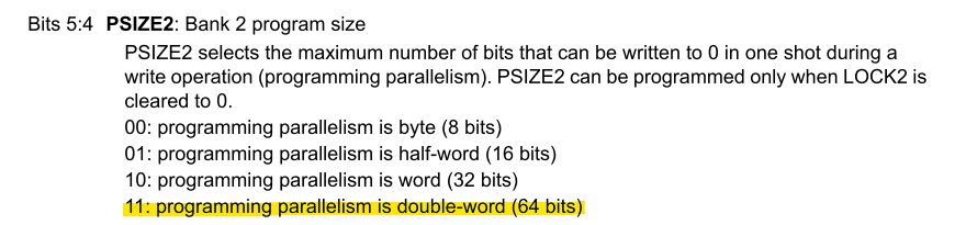

Check also how you erase. Is the "voltage range" parameter good?
I think it is "good". I am using a voltage range of 4 AKA a programming parallelism of double-word. I assume this is OK. There is no documentation in the reference manual about which is "correct" - it is just a tradeoff between timing and power consumption.0693W00000StuF9QAJ.png
I should also note that I am using the HAL_FLASH_Program() function to carry out my programming.

Please check the Flash register FLASH_ACR in Reference Manual Reset value: 0x0000 0037. So 3 stands for WRHIGHFREQ (Bits 5:4) and 7 stands for Latency
Also note that the application software has to program them to the correct value depending on the embedded Flash memory interface frequency.
Hi @F.Belaid​
Thank you for the response. I forgot that all registers have a default reset value that is defined in the reference manual. Thank you for pointing that out. Still, the reset value, 3, is not a valid setting for WRHIGHFREQ for any clock frequency on STM32H743 according to Table 17 in RM0433, which I think is strange.
In addition, neither the HAL or STM32CUBEMX platform handle setting this value, even though they handle the LATENCY - the auto generated code for 240Mhz AXI Bus sets the LATENCY to the recommended value but does not set the WRHIGHFREQ.
Unless the user reads the reference manual and happens to see Table 17 and then goes digging in the FLASH LL drivers, they would probably not know how to set this setting.

3- My understanding is that a value set to 3 for WRHIGHFREQ shouldn't create an issue. The reset value covers all intended frequencies in the table but in larger latency. Can you change WRHIGHFREQ to the value 0x2 for example? If you confirm that updating this bitfield resolves the issue, we need to investigate this on our side and report it internally for HAL and CubeMX implementation.

  6. I am using HAL_FLASHEx_Erase() to perform the erase procedure. Reviewing the code, this seems to follow all the steps in 4.3.10 for the flash sector erase process. I use FLASH_VOLTAGE_RANGE_4 when this step is executed.
