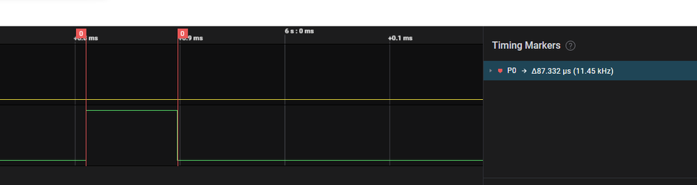

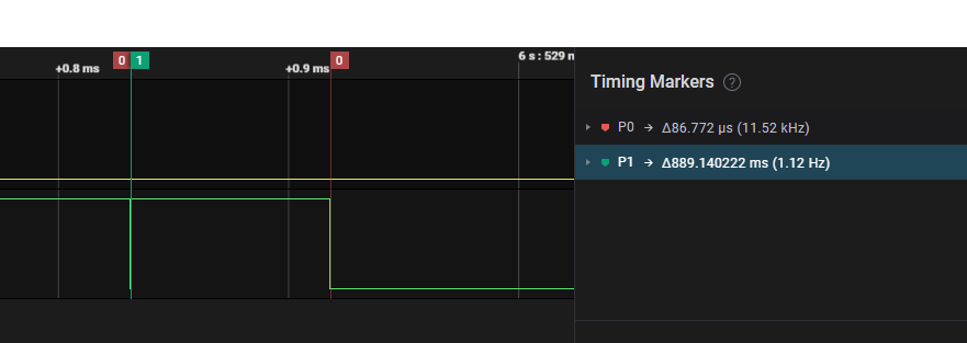

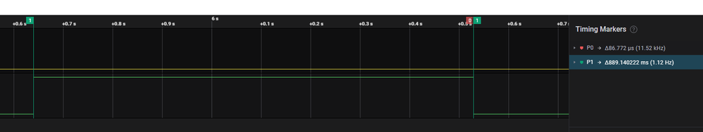

All my timing measurements look like this, regardless of whether or not I clear the RDPERR2 bit:
Flash Writes:
Flash Erase (P1) Followed by Flash Write (P0):
jaakjensen
I feel I am back to square one. I still do not know what causes this issue. Based on the timing measurements, the chances of a reset happening during a flash write is very rare (87usecs required to complete a flash write every 10 seconds) = ~1/100,000 chance.
An erase might be more likely but the likelihood of that is also very unlikely. It would require it be powered on and writing data for: (10 seconds per write * 128kbytes/32 bytes per write = 11.37 hours to fill sector and then issue an erase request) and then powered off exactly at that second when the erase request occurs.
