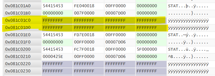

I am noticing that sometimes (it seems) a "state" write fails and we are left with an unwritten block in memory. I don't know why it fails yet but I noticed that there is an unwritten 256 bit block in memory. The system assumes that this previous write was successful and starts writing the next block 10 seconds later.
During the next bootup, the program scans for the last 256 bit block in memory with the first word being "STAT" in ASCII. It sees this blank block where a write failed and assumes that the block before it is the last successful saved state. It then starts writing its state from here. It will eventually overwrite the following two 256 bit blocks, which cause an ECC code to trip. It sometimes happens immediately when the following blocks are overwritten or during the next power cycle.

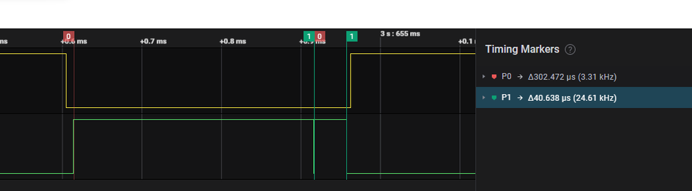

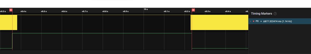

To give some more context about my program: there is a high priority interrupt that goes off every 1 msec, which is used to process a bunch of data supplied by the DMA. When the processing is done (typically after 0.6 msecs) we flush the cache and then release the CPU to handle lower priority tasks such as writing the state and updating the UI in the while() loop.
When things work as expected, the erase of the sector takes >4 seconds to complete. I just noticed it blocks the high priority interrupt that handles processing of the data... this is strange and I don't know how it is able to do this.0693W00000SvONKQA3.pngSometimes though, the erase is very brief (see below) and the high priority interrupt is not blocked. The P0 timing marker represents the "erase" while the P1 timing marker represents the "write". It is often during this situation when the failed write occurs.

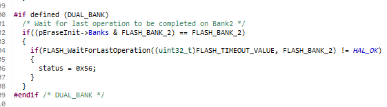

It seems during the second scenario, an HAL_ERROR is returned by HAL_FLASHEx_Erase().
jaakjensen
The error reported in HAL_FLASHEx_Erase() is from this section. I modified the return status to confirm which section reported the error.: 0693W00000SvOVAQA3.png
jaakjensen
It seems like this error may be from a "RDPERR2" ? The PFLASH error code returned is 0x8080_0000. Which is strange because I have not set up a PCROP-protected word or a RDP-protected area.
