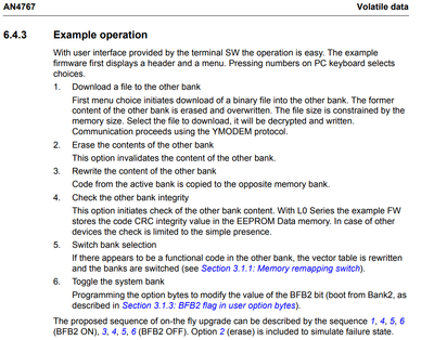

Hello everybody,
having a dual-bank Flash memory into an STM32G0 MCU, what could be the best approach to update the user application ?
By using the swap feature or by making a copy of the new user app from Bank 2 to Bank 1 (by using a bootloader)?
Thanks
SofLit
I think the answer to your question is available in the AN4767 "On-the-fly firmware update for dual bank STM32 microcontrollers ":
