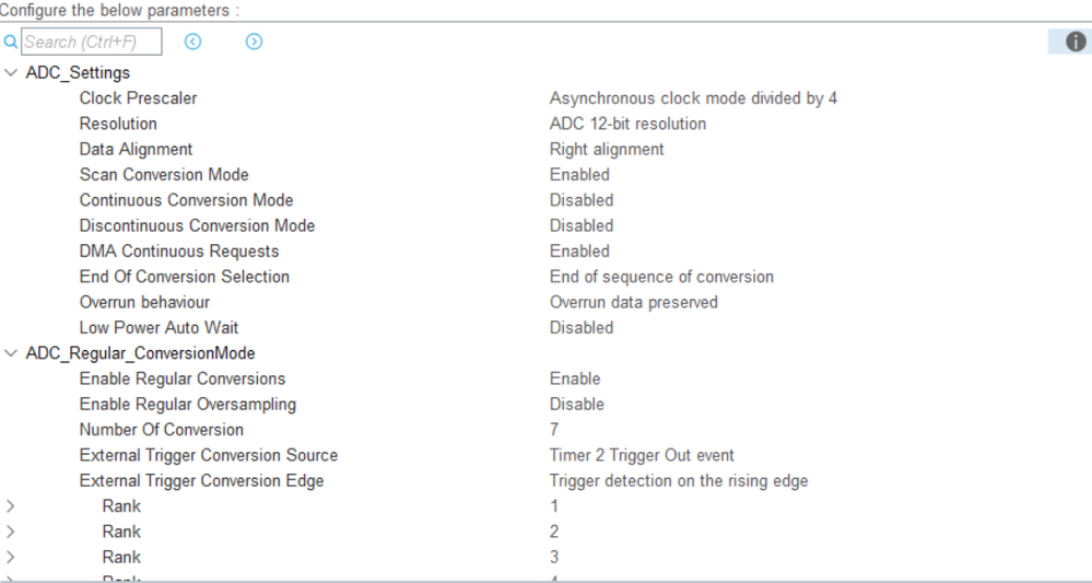

All of the circuitry works except RF, which I haven't tested yet, and I've written the code in STM32CubeIDE to read the inputs.  Here are the specifics along with something I'm not sure about:
  • It uses a timer set to read all of those at once every 200ms - which is probably around the granularity i'm looking for.
  • The device it will control really just needs 8-bit data.  Currently I have the ADC resolution set to 12-bit and I map that to a range of 0-255 but I've also experimented with just using 8-bit resolution in the ADC (which would eliminate the need to map).  I only went higher because I'm looking at how best to read and store the voltage.
  • When the timer fires I just read the 7 analog values and put into a struct.  I also read the digital values at the same time as it seemed like a good place to do it without using another timer or wait loop.  Not sure if that adds issues being done in the callback.
  • The only issue I seem to have is that my joysticks X and Y are way too sensitive.  No matter what resolution I pick (or other setting I play with) they reach full value with minor joystick movement.  Same brand I used with Arduino and I don't recall seeing that there but this is custom hardware and STM32 so not sure any of the other settings could be causing that (or if they're just crappy joysticks)
Questions:
  1. Is there a pro/con with different ADC resolutions (i.e. is it more efficient and/or less overhead on the processor to do one vs. the other if I have a choice)
  2. I'm not sure what to set the sampling time to - or really what that does.  It's currently at 247.5 cycles but I didn't really see a difference when it was at 2.5 cycles. Should this be higher or lower, etc - especially since I'm reading the digital values in the ADC_ConvCpltCallback method
Coming from the Arduino world all of the ADC conversion stuff is new to me, so learning it as I go.  There are a lot of options to choose (trigger conversion edge, sampling time, offset number, overrun behaviour, end of sequence selection, etc.) and it's hard to tell from the documentation what they do and how they all work together.  This all works so I'm really curious if someone with more experience has any ideas on if it could be better, more efficient, etc.
Here is my ADC setup
There isn't a lot of custom code, most is IDE generated HAL stuff, so below are the relevant sections
