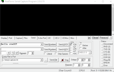

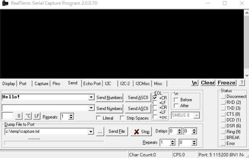

What is the correct flow to use HAL_UART_Receive_IT() to receive uart data?
The first package is lost first its first char,
Here is the flow used now,
From the gif, you can see "H" is missing for 1st package, and all normal for others.
The problem is that the we call "HAL_UART_Receive_IT(&huart3, &data, 1);" outside the endless while(1), which lost the first char "H"
Maybe it can solved by LL lib to solve it, I just want to know if it is possible to use all HAL function to implement a normal flow to receive data correctly,
Thanks,
E-John

Code is mostly okay except:
  • Use a global variable to store the received byte. You're using a local variable which goes out of scope immediately. This will lead to stack corruption.
  • Your first call to HAL_UART_Receive_IT uses a different variable than the subsequent calls. This is the reason for the lost "H".
  • Read the variable before you do the next HAL_UART_Receive_IT call. Since UART is slow, probably isn't making a difference here but it's bad practice since it introduces a race condition.

E-John
Hi TDK,
Thanks for your guide, I have modified the code as you mentioned, it works.
         ---> modify code to use global variable "g_rx3_data" to store the received byte.
        ---> yes.
       ---> Understood.
