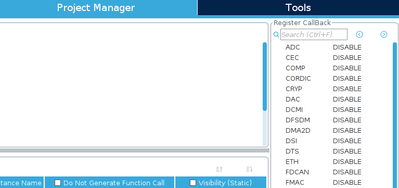

Of course the FDCAN2 interrupt 0 is activated on CubeMX :
What's wrong?

did you enable callback in Cube ?
in call back/int check, which fdcan is calling - you use 2 of them , so you need to know, which one is coming.
Yep, the callback is well implemented.
I finally found the solution : I had to offset the RAM with 14 words to make the FDCAN2 working.
Now both FDCAN1 and 2 are working well.
Thank you anyways for your help 🙂
