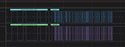

I used your project with a little modification, I can see the frame on Tx pin as well as on Rx.
I used two NUCLEO-G0B1RE boards connected with two transceivers. The same example uploaded to the two boards.
This is what I can see with a CAN analyzer: Blue: Tx, Purple: Rx.

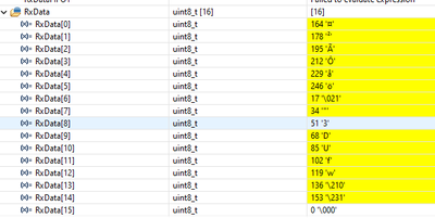

I'm also seeing the message received, which are sent by the other board:
So, either there is something transmitted on Tx but there is an issue with your logic analyzer configuration or you have something on your hardware. So check all your connections, check the GPIO pins used etc..
