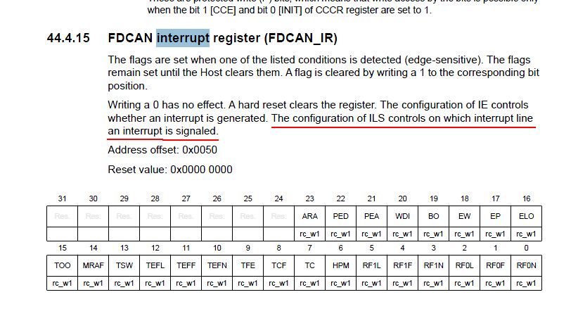

I got a hard time comprehending about the two interrupt lines in the manual.
I can really see a "connection" between certain sources to the interrupt lines, nor can i find a register to connect them.
It seems to me, that i only can decide what interrupts will fire, and what interrupt line they will go to then. But i cant think of, how i could have both interrupt lines running in paralell.
I think i missed something.
Is there a better information about this out there?

After digging into HAL sources I can summarize:
The interrupt sources in the register FDCAN.IE are grouped into 7 source groups in the register FDCAN.ILS.
The register FDCAN.ILE allows to enable 2 different interrupt lines: EINT0 and EINT1;
any of the 7 groups in the register FDCAN.ILS can be redirected to only 1 of the 2 lines EINT0/EINT1.
According to the function HAL_FDCAN_ConfigInterruptLines() and HAL_FDCAN_ActivateNotification():
- by setting FDCAN.ILE.EINT0 = 1, every source group in FDCAN.ILS which has its bit == 0 will be redirected to EINT0 and handled by FDCAN_IT0_IRQHandler() if any of its sources is enabled in FDCAN.IE;
- by setting FDCAN.ILE.EINT1 = 1, every source group in FDCAN.ILS which has its bit == 1 will be redirected to EINT1 and handled by FDCAN_IT1_IRQHandler() if any of its sources is enabled in FDCAN.IE.

FDCAN interrupt register (FDCAN_IR) says:
The flags are set when one of the listed conditions is detected (edge-sensitive).
Since they're not level-sensitive, perhaps they can be lost under certain circumstances while serving an handler.
By doubling the handler, they will be intercepted by the other on the exit from the previous.
I'm not sure of that, but is the only explanation I see.
