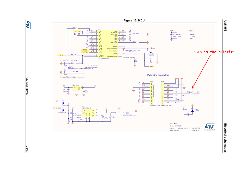

Trying to receive data on MCU (L432KC) configured as SPI slave. I have tried using interrupt and DMA, but no luck.
I have set up the circuit like this : 1 MCU acts as master sending 1,2,3 every 500ms interval (I hooked up master lines to scope and the signals are generated correctly). On the other MCU configured as slave, I've connected a RGB led, which is supposed to react to 1,2,3.
Here's my code (interrupt handler commented)

I've tested the LED part of code separately, blinking R,G and B and it also works fine.
Again, tested interrupt and DMA separately, so ignore one while considering the other in the code. I've tested it with a normal receive subroutine too, but I had not much hope with it anyway.
Just failing to receive data on slave. What am I doing wrong?
EDIT : Here are the waveforms on scope. When disconnected from slave, the waveforms are perfect. However when I connect the master to slave, there is some noise and the SCL line has a amplitude of 900mV.
12 REPLIES 12
> I checked user manual to see if PA5 was connected to something and don't really see anything.
Hummm...
In a minimal program, try only setting PA5 as GPIO Input with pulldown, and measure.
waclawek.jan
No, I use barebone gdb which is not the easiest thing to use; but Keil should be usable for it.
waclawek.jan
> My slave in this program is a Nucleo L432KC.
Which user manual did you check?
