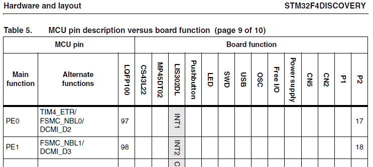

but with the gpio disconnected from the pin the ohmeter read 32ohm between (GPIOE_Pin_1|GPIOE_Pin_0) & THE board's GND pin... when it should be completely disconnected in floating mode... missed something specific about GPIOE ? faulty chip / bad batch (anywhere i can find this kind of info) ? bug in silicon ? anyone have any other idea ?

Posted on April 20, 2013 at 17:52
You understand that PE0/PE1 are connected to other components on the board, right?
PE3..15 are not connected to anything.
Make sure the clock is enabled for the GPIOE bank, that you can read/write values into the registers.

What i don't is why, in spite of beeing setup as described sooner it's not working as documented for gpioe but is indeed working as documented for gpioc (just by changing the adressed gpio in the defines) and the interrupts fires quite correctly on press or release of the buttons.
gpioe is behaving as if i had set it up with a pull down (is 32ohms compatible with the weak pull down embedded resistor ?).
i still think there's something either wrong with gpioe on my chip or board or i missed something in the documentation that is related to this particular gpio port. that's what i'd like to know since i have to evaluate this board as a possible candidate for an embedded arm workshop i'll give next year and either document it as expected behavior ...or just as a possible default (in this case the chances are the boards we'll order will be from another batch and won't suffer from it)

Posted on April 21, 2013 at 13:51
jejeva
Posted on April 21, 2013 at 16:58
clive !
My hero ! i neglected to look at the board datasheet itself !
Now i understand :)
(just maybe next time indicate the doc reference, had a hard time digging this one)
thanks a bunch !
