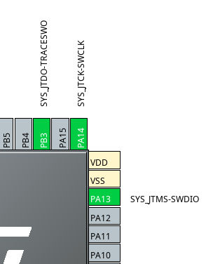

Sure, if you use the pins for anything , debug is gone.
Its first on a setup for the cpu pins, to define the pins for debug - if you want debug at all.
No configuration needed, they work at reset already; just do not touch them. :)
Read and  see in ds, pin descriptions , pin definitions at start/reset,
or just see in Cube -> pinout view, set debug or trace and you see the needed pins:
(on F103 in pic)

Simple programs run fine. And I cannot fathom even potentially what I could do to make the debug buggy. Perhaps there are some pins on the MCU that are used for the ST-Link debug, and I perhaps messed up with their configuration?.. If anybody knows, if there are such "special" ST-Link debug pins, which I shouldn't use?
(on F103 in pic)
Bingo!!! That was it! Shame on my old bald gray-haired mug! OMG! I used one of those pins as SPI CLK. God *** it. This thread is worth remembering, as I have struggled for about a month, unable to understand what the hell was going on. And you know what, if the debugger just stopped working altogether, the whole issue would be easy to trace, but the point is, it still worked, just not always, and not everything. So basically speaking, it became moody, instead of dead, and that is what just drove me nuts, because the behavior was inconsistent.
