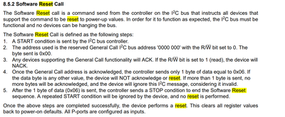

Hi @TDK ,
I am working with stm32g491re.I am communicating with TCA9537(Ioexpander) from stm32 through I2C. It will control a realy. For my product EFT(Electrical Fast Transient) testing, After starting EFT teat relay getting turned off and not recovering.
So i modified the code.
void ioexpandercheck(){
		uint8_t check[1];
		HAL_StatusTypeDef status=tca9537_read(&hmcp, TCA9537_REGISTER_INPUT,check);
		HAL_Delay(10);
		if(status!=HAL_OK){
			HAL_I2C_DeInit(&hi2c3);
			HAL_Delay(10);
			HAL_I2C_Init(&hi2c3);
			HAL_Delay(50);
			HAL_GPIO_WritePin(GPIOB, GPIO_PIN_2, 0);
			HAL_Delay(5);
			HAL_GPIO_WritePin(GPIOB, GPIO_PIN_2, 1);
			HAL_Delay(5);
			tca9537_init(&hmcp, &hi2c3, TCA9537_I2C_ADDR);
			tca9537_iodir(&hmcp, TCA9537_CONFIG_IO12_OUTPUT);
Here continuously I am reading the expander pin if read is not ok I am resetting both I2C and ioexpander and reinitializing the ioexpander. With this i can able to recover the relay operation in EFT but its not stable.
In above ioexpander reset i done using reset pin of ioexpander.
Instead of doing through reset pin, in datasheet also they mentioned how to do with software.but i am conused about implementation.
Can anyone suggest.
Thanks
Please make a new thread with this question. You cannot issue a software reset if the bus lines are being held, which is what we are discussing in this thread.
