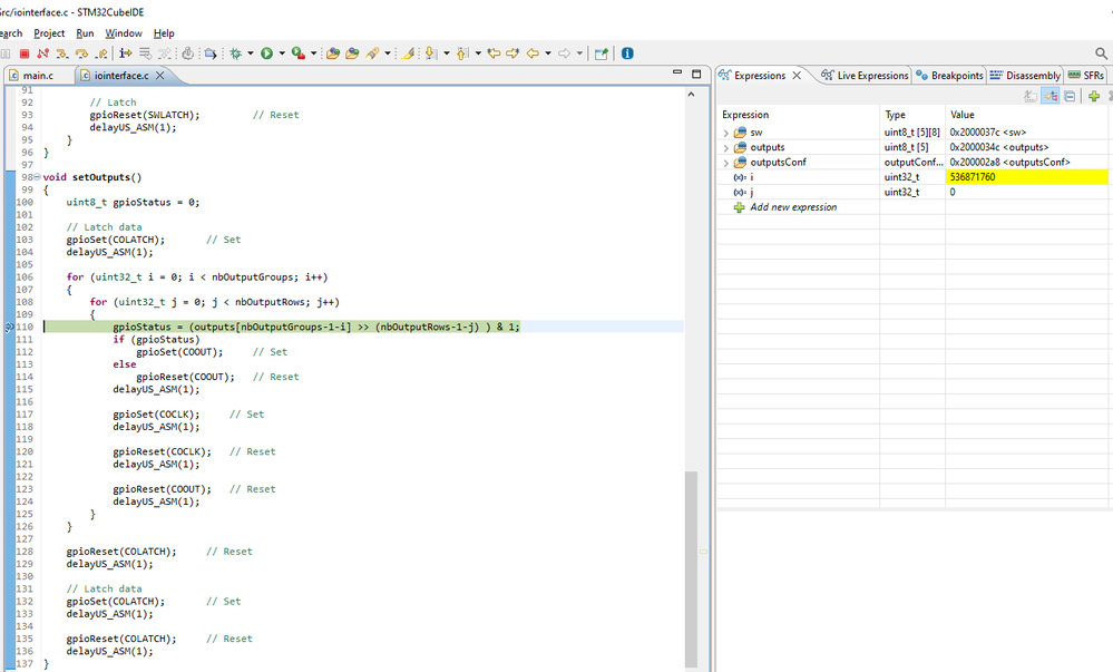

Hi, I'm having the weirdest bug with this code. It's just 2 for loops expecting to count from 0 to 5 and 0 to 8.
When compiling with O3, i becomes very high and the execution gets stuck in the loops.
Running STM32 Cube IDE 1.9.0
STM32Cube FW_F4 V1.27.0
com.st.stm32cube.ide.mcu.externaltools.gnu-tools-for-stm32.10.3-2021.10.win32_1.0.0.202111181127/tools/bin/../lib/gcc/arm-none-eabi/10.3.1

By the way, the loops use constants:
#define nbOutputRows 8
#define nbOutputGroups 5

It could be that i has been optimized out and the debugger doesn't monitor it correctly. I would imagine the access to outputs[] to cause a hard fault if i is absurdly high.

Enable at least minimal debug level (-g1) in the C/C++ Build Settings for the Release Config to get plausible values for local variables. It also makes sense to debug step-by-step, if possible at instruction level, to understand what's happening.
Make sure that the function calls have a side effect (like assigning to a volatile variable) and are not optimized out.
Comment out parts of your code ("bisecting") and observe changes.
Doubt that you caught a compiler bug.
hth
KnarfB

When I comment out line 110 it does say that "i" is optimized out and the infinite loop goes away.

The main difference between O2 and O3 seems to be the loop unrolling.
The function calls do have a side effect as it is setting a pin high or low in the loops:
if (gpioStatus)
gpioSet(COOUT); // Set
else
gpioReset(COOUT); // Reset
Changing the type of the table output[] to volatile fixed the issue in O3, the code no longer hangs and the loop counters work as expected (even though they struggle to show properly in the Expressions view).
I have attached the source file and the disasm compiled with O3.
