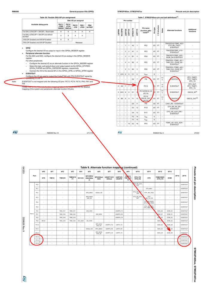

['F4 documentation] "Weak pins" and EVENTOUT
waclawek.jan
The same applies to the rest of the pins (PI8, PH0, PH1), too.
And, of course, I assume this is to be fixed accross all 'F4 DS, maybe other families too; I won't go check them, that's ST's task.

Hello @Community member​ ,
Thank you for your reported issue and for helping us improve our documentation.
I will raise this internally for fix.
