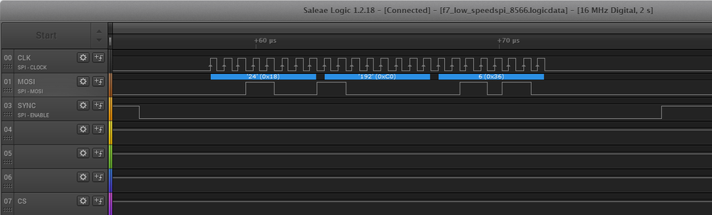

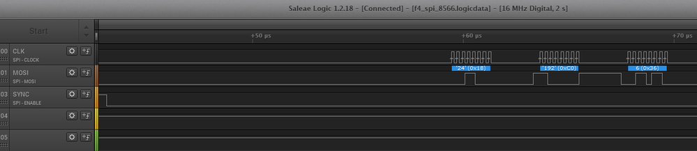

During testing an SPI DAC (TI DAC8563) on an STM32F446RE (where it works) and on an STM32F767ZI (where output is always 0V), I noticed a different SPI clock waveform.
In F4 you have three "8 pulses" signals from CLK (the message from MOSI is 24 bit), while in F7 you can read a single 24-pulse signal on CLK. The two programs are quite the same (generated by CubeIDE), so I suspect that the DAC8533 doesn't recognize the different words. The duration of signals are quite the same for the two MCU (10-15us)
This is the F4:
This is the F7:
Then I modified the F7 config to have the same SYNC Low timing (40us) but nothing changed.
Any idea?
Thanks very much,
Mario

SOLVED!!! The overcurrent LED sometimes glowed up... I supplied the DAC with an external supply and all works great!
I'm sorry for not realized it immediately, but my F7 is quite hidden and I thought that it was the ST-LINK LED.

There are no errors in the waveforms here. The delay between bytes is just to let the cpu catch up. It can be eliminated by using DMA or by better optimizing the code. The F7 SPI peripheral has a FIFO which can help to eliminate the delay.

Thanks for your answer. I thought that the F7 features "caused" the different behavior, but I'm no able to understand why the F4 works while the F7 doesn't. DAC8563 SPI can transmit data @ 50Mhz clock so it shouldn't have problems.
My configuration is "basic", no DMA or other optimization, just code from CubeIde with the same parameters for the two MCU...
Not real sure of why it's not working, but this isn't an apples to apples comparison. The SPI clock on the F4 is way faster than the SPI clock on the F7. Just eyeballing, it appears to be a factor of 4 or more faster. I would sort out that difference first.
