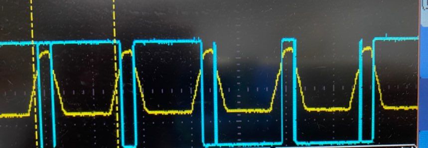

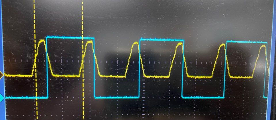

ssooki
Modified the exti function to only execute gpio toggle.
Photo 1 is the interrupt operation to be implemented. (Toggled for each falling edge.)
The second picture is case2.
The data is changing within a short period of time as if some data was being transmitted.

waclawek.jan
By enabling FMC you added noise and exti triggers on that.
Nikita91
Lead II
It is clear that there is noise around the trigger threshold of exti.
The exti1 signal must have much steeper edges.
ssooki
I did some more tests. Below are the conclusions from the tests.
  1. Even if I changed the gpio port, the noise was the same.
  2. A problem occurs when LTDC or FMC initialization code is entered.
It seems that the data transfer from the touch screen is affecting the exti.
Is there anything else we can do to test the cause?

ssooki
found the cause. There is no problem except the red color of the touch LCD RGB data.....
It is strange that data is periodically transferred to gpio...
The current situation is as follows.
  • exti1 interrupt : SMPS signal is being input, Trigger on every falling edge(16ms), and Toggle GPIO whenever triggered.
  • Red data is affecting the trigger.
​If anyone has similar symptoms, please advise...
