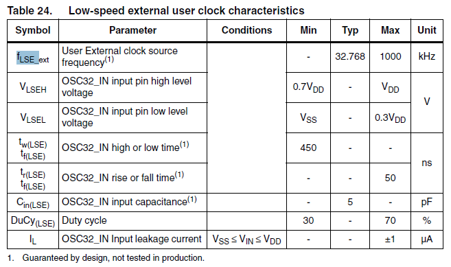

The LSE could use a 256 or 512 KHz crystal.
Inventive, although... I can't find any information on the capability of the LSE circuitry to drive anything other than a 32.768kHz crystal... JW- Mark as New

It's not a coincidence that this table is found under ''Low-speed external user clock generated from an external source'' header.
I'd be very surprised if this would constitute a guarantee that the LSE circuitry can drive a 512kHz crystal. JW- Mark as New

Making better use of the extra post generated by crappy forum software: I just had a look at AN2867.
The Revision history has this to witness: 17-Jul-2012 - [revision]6 - Whole document restricted to STM32F1 devices. JW- Mark as New

Honestly, I don't know if the internal Pierce oscillator circuit can be abused in this fashion, or if an external oscillator source is the way to go. I don't have any Pierce targeted 512 KHz crystals to hand (or 256, 768), so probably not something I'm going to experiment with.
