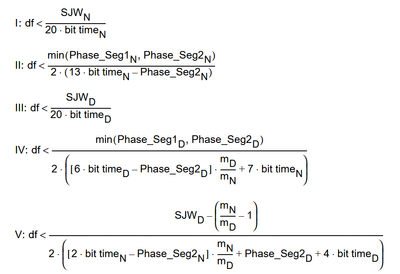

I am considering to use several STM32 microcontrollers to develop CANFD devices. I just saw CANFD Bosch specification v1.0, and more particularly scope 8 which defines the following requirements:
Unfortunately, on all STM32 I have been confronted so far, you cannot specify exactly PROP seg and Phase seg 1 indivually but just the overall (Prop_seg+Phase_seg1). Which is fine to determine the sample point but I am not able to check if my bit timings are meeting the requirements above as I cannot discriminate prop seg length from phase 1 length.
1. Is the dispatch between propseg and phase seg 1 constant over all devices ?
2. Is the propagation segment always fixed to 1Tq for example ?
Any insight regarding this would be appreciated,
Best regards
