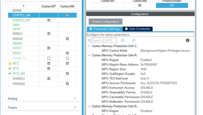

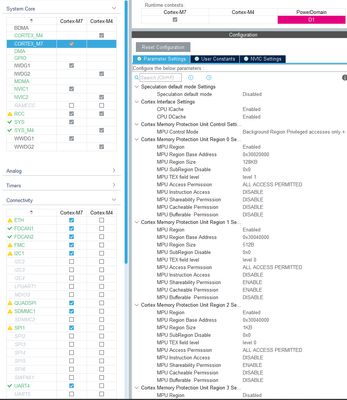

I used Adam Berlingers post How to create project for STM32H7 with Ethernet an... - STMicroelectronics Community (Thank you Adam!) but changed the MPU and ETH values as shown below, since the orginal posted values lead to the same issues as described here.
M7 settings for Ehternet
M4 settings for ADC to DMA
ETH connection
for more details see the attads .ioc and load files.

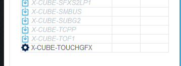

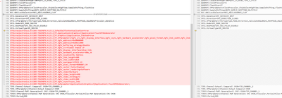

‎2024-06-03 11:42 PM - edited ‎2024-06-03 11:48 PM
CubeMX 6.11.1 fun fact
The project is taken form the provided TouchGFX Riverdi example and can be build and simulated successfully in TouchGFX Designer, but when opening the .ioc file in CubeMX 6.11.1 it shows no selected TouchGFX ...
... even when it is in the .ioc file, as shown below on left side. When reselecting and saving in CubeMX it will disapear from .ioc file as shown below on the right side.
- CubeMX was reinstalled but shows the same behaviour still ...
- TOUCHGFX 4.23.2 is present on the system
- all firmware used by CubeMX and CubeIDE is stored at D:\STM32Firmware
‎2024-06-05 8:52 AM
Hello @PGrif.2 ,
I don't seem to get the way you are setting your regions and sizes in MPU config, and it seem to be you issue. you need to make sure of the size of your regions and have in mind the Memory aliasing happening between CM4 and CM7 to get this right.
to make sure you are getting the MPU config right check this helpful youtube tutorial.
regarding the issue with LWIP configuration it will be fixed in the next release.
