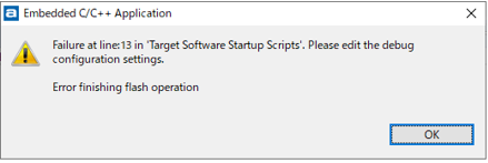

I have the following error when I was trying to debug using TrueStudio(v9.3.0).
0693W00000D2PylQAF.pngThe specific steps that caused the error are as follows.
1. Connect STM32F100RB※1 to the PC.
2. Launch TrueStudio(v9.3.0)
3. make project
3.1 [File] -> [New] -> [C Projet]
3.2 Select Embedded C Project
3.3 Select [STM32F1] -> [STM32VL_Discovery]
3.4 Next (default setting)
3.5 Next (default setting ※2)
3.6 finish
4. debug project
4.1 [Run] -> [debug configuration]
4.2 Select [EmbeddedC/C++ Application]
4.3 Push [debug] bottun
4.3 the above error is output
※1 STM32VLDISCOVERY - Discovery kit with STM32F100RB MCU - STMicroelectronics
※2 ST-LINK is selected​
Could you please confirm?​

Hello @Myasu.1​ and welcome to the Community :)
Have you tried with old release of TrueStudio (uninstall v9.3.0 TrueStudio version and install for example Version 9.0) ?
Please keep me informed about your update.
When your question is answered, please close this topic by choosing Select as Best. This will help other users find that answer faster.
