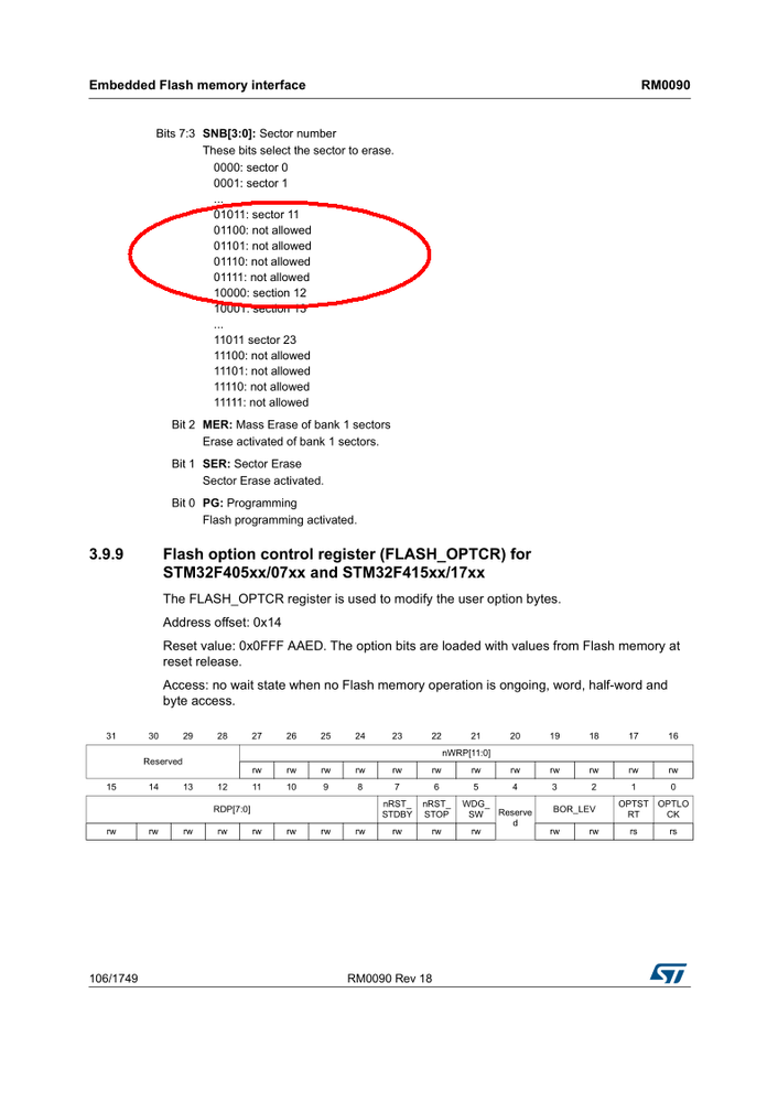

I have STM32F427zi supply with 1V8. And I try to erase his flash from sector 5 to sector 23, but sector 23 is not erased. STM clock is set to 144MHz. Latency set after document RM0090.

For check I use debugger to view data in flash memory. At the picture, you can see that flash memory is wrong erased. The last 0x081FFFFF is end of sector 23.
Any idea, what is wrong?

An error was found.

     Bits 7:3 SNB[3:0]: Sector number
		These bits select the sector to erase.
		0000: sector 0
		0001: sector 1
		01011: sector 11
		01100: not allowed
		01101: not allowed
		01110: not allowed
		01111: not allowed
		10000: section 12  (bank 2 sector 0)
		10001: section 13
		11011 sector 23
		11100: not allowed
		11101: not allowed
		11110: not allowed
		11111: not allowed
    /* F42x, F7xx: Need to add offset of 4 when sector higher than FLASH_SECTOR_11 */
    if (sector > 11)
    	sector += 4;

If the sector is bigger >11 you must increment setor +4.
The debugger might've presented data from the ART Data Cache. Similarly as you disable/enable the instruction cache above, you should do with data cache, too.
True, the data cache is 4 lines x 128 bits i.e. 64 bytes, and what you've shown was 128 non-FF bytes, so that was not the problem here.
Nice catch, thanks for sharing!
