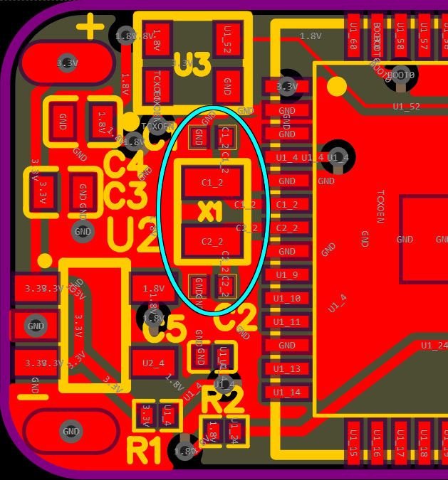

I designed my own PCB - Micro Cat Tracker (26.5 x 12 x 1.5 mm; 1 x 1/2 x 1/16 inches) sewn into cat collar. See attached picture.

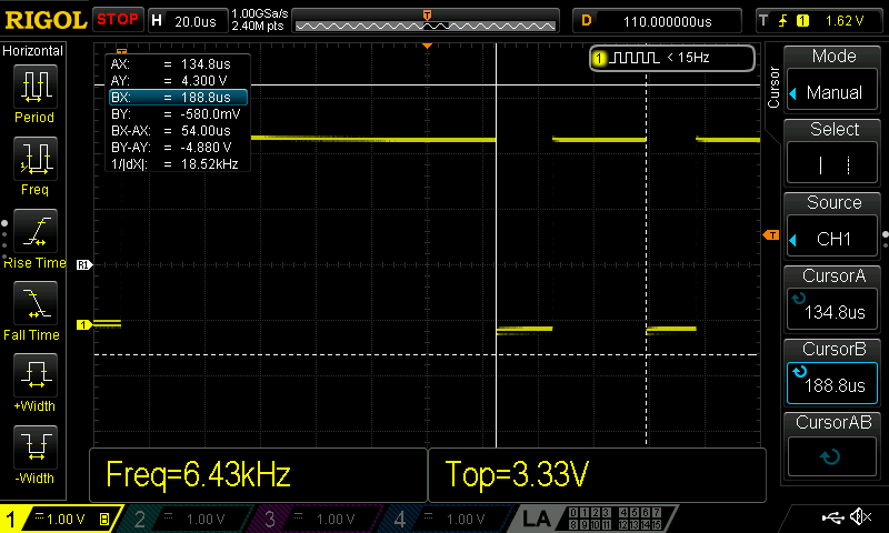

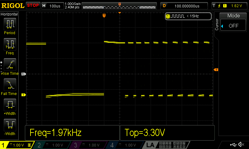

I created test program in STM32CubeIDE, just to enable LSE on MCO PA8 pin and found out the LSE is not running (as I assumed). When I touch crystal by a finger I get random oscillations I catched on attached oscilloscope screenshots.
I don't like to rebuild PSB so I will try to replace the crystal with two CL capacitors by MEMS oscillator and will check the output again.
Note, that that might require to set the bypass (LSEBYP). I am not sure what happens if you don't do that, and what is the impact on LSERDY - that all might make troubles in the original firmware.
Before you do the hardware change, you might want to play with LSEDRV, and also try to carefully wash/clean the surroundings of the crystal.

Maybe the PCB design (4 layers) is responsible for not working LSE. I didn't expect any problems with 32.768 kHz. U3 is TCVCXO oscillator 26 MHz running well (Vpp = 1V).
Crystal used TFX-03 (+/-20ppm, CL=5pF), capacitors 6 pF.
