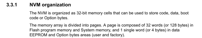

In STM32L0 RM0377 reference manual it can be read:
which suggests me that the microcontroller hardware performs a read-modify-write operation on the 4 bytes of the same word. But here is where I am not sure.

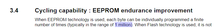

‎2017-08-08 10:39 AM
Thanks Amel,
I found in that Application Note the following info:
Is this a general statement about EEPROM technology or about how EEPROM is written in STM32?
If I remember correctly the Microchip extarnal EEPROM chips write in blocks of 16 bytes. Whenever you write one byte you affect the endurance of the other 15 bytes neighbors in the same page.
