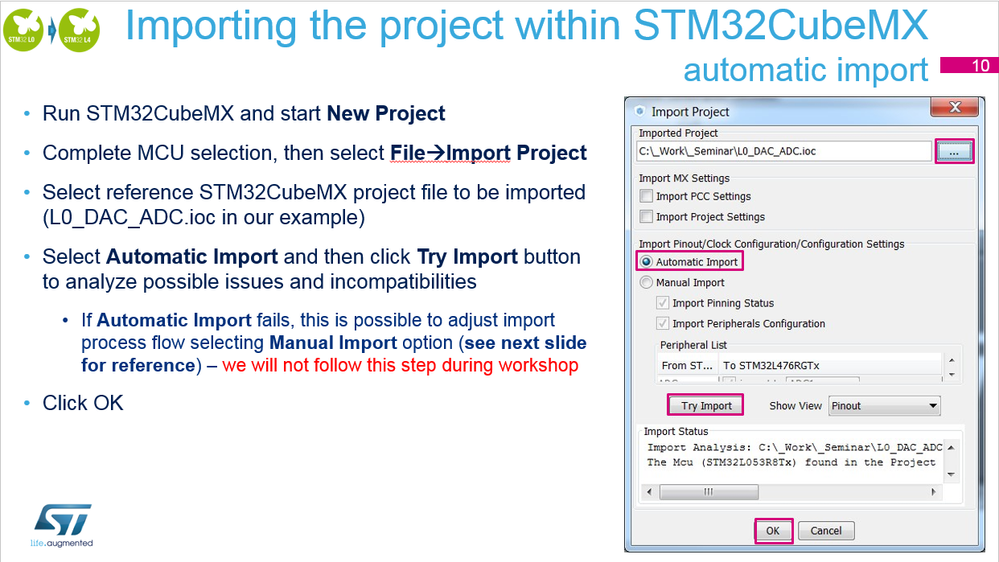

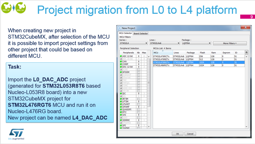

CubeMX has already a feature, which allows reusing of existing project for different STM32 family. Please see below two slides from STM32 ecosystem workshop, which demostrates how to use this feature.
I hope this information will be helpful to you.
