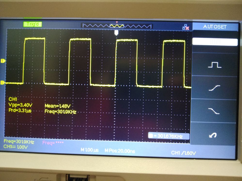

Hi Clive ,
I'm toggling the GPIO pin for 50us using above function given by you.but i'm not getting the exact delay .0690X00000AAVRRQA5.jpg
Please let me know how to fix this???
Don't You see that Clive's code actually waits clock ticks not microseconds?
That, and one might have to compensate for cycles eaten entering/exiting.
I would tend to use precomputed constants so as not to repeat the math.
Also your wave-form doesn't look 50/50, so clearly doing something else there that you need to adjust/compensate for.
Hard to understand what exactly you're doing when you fail to provide code.
