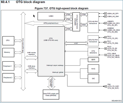

Hello @MADHU2
When HS uses the internal FS PHY, it shares the same PHY hardware as the FS controller. This means both cannot operate fully independently at the same time because the PHY is a shared resource.
Since the PHY is shared, only one host controller can use the internal FS PHY at a time.
Unfortunately, examples with both FS and HS active simultaneously using internal FS PHY are non-existent.
You can try to merge FS and HS examples carefully, but expect to handle PHY sharing issues manually.

Hello @MADHU2
After double-checking, the STM32F7 USB_HS and USB_FS do not share the same PHY hardware. I was initially confused by the STM32MP1, which does share access to the PHY.
I apologize for any confusion caused.
The issue appears to be more related to FatFs rather than USB. Currently, I need to confirm whether FatFS can handle double instance registration. I will get back to you as soon as I have useful information that can help resolve the issue.
