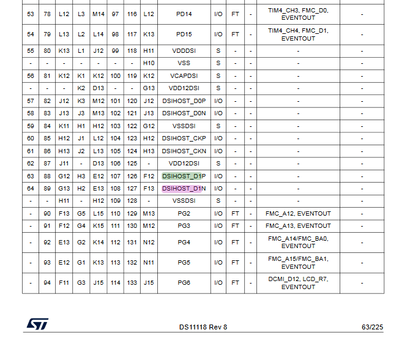

I'm wondering if there's a way to use the DSIHOST_D1P and D1N pins as GPIOs, or if it's possible to simulate GPIO functionality on these pins. Currently, I don't see any GPIO configuration options for them in STM32CubeMX. The MCU in use is the STM32F469ZIT6.

There does not appear to be a GPIO port associated with those pins:
No, committed LVDS drivers uncluttered by GPIO baggage..
