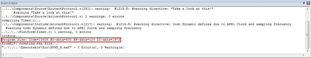

Hello guys,
I´m developing an application in Keil uVision and I am getting this message.
What does this parameters mean?
Program Size Code = ¿Flash?
RO-Data = ¿?
RW-Data = ¿?
ZI-Data = ¿?

Code - Executable Instructions
RO-Data - Read Only, Constant data/arrays
RW-Data - Read Write, Variables in RAM with values
ZI-Data - Zero Initialize, Variables in RAM which are zero/cleared
The FLASH foot print is the combination/sum of Code+RO+RW, the RW data is there because the startup/run-time has to copy it from fixed ROM into uninitialized RAM, the zero memory is just described and cleared by the same code.
The RAM foot print is RW+ZI
