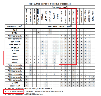

I am trying to configure H750 to transfer data between internal SRAM and external SDRAM, I got everything setup OK but with some problems (also monitor data bus with logic analyzer). So I checked with ChatGPT, surprisingly, ChatGPT said H750 (actually it said the same thing about H74x)  does not officially support memory-to-memory transfer, ChatGPR said use MDMA instead. Before I jump into MDMA, just want to make sure what ChatGPT said is true?
Thanks.
From the reference manual / table 3:
So you can do transfers from/to SRAM1/SRAM2/SRAM3 <-> FMC. you cannot do that transfer to from DTCM/ITCM. You need MDMA for that.
BDMA could not do that kind of transfer.

Reference Manual does not say any thing about this (at least not that I could find), it just gives a general description not specifically for SDRAM<->SRAM
Yes, I already checked the reference manual for the DMA, but don't know what I should look for, I've spent a whole day trying it on real hardware and it seems DMA between SDRAM and SRAM works, but that is just for very limited test I've done! Could you elaborate more?
