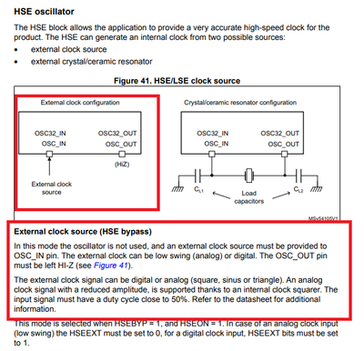

What is the HSE Bypass mode?

Hello @mƎALLEm ,
Thanks for the updates.
What is Bypass mode? Can you please provide guidance for this?

For such questiion you need to refer to the reference manual of the product: RM0477:
You need to use OSC_IN only. The crystal oscillator output connected to OSC_IN.
If you are using CubeMx, this is the configuration:
Hope it's clear now.

JK1234
@mƎALLEm
Ok thanks for the clarification.
