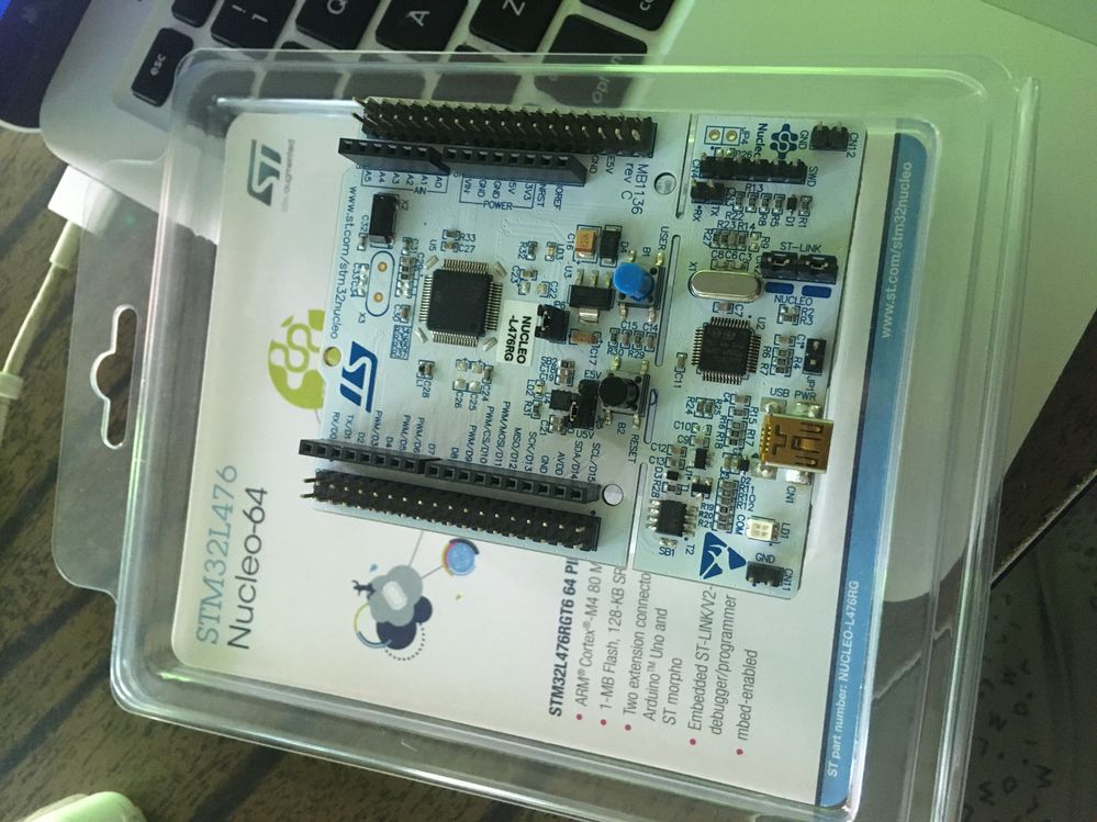

Hi @Sree​ ​ ,
Did you actually try the individual steps with hardware? All 5 steps? Can you please describe some of your findings - were the examples clear, was the PC software easy to find, download and install, did the Android application work as expected, did the examples run out of the box without any problems, do you find them illustrative, would you want to expand on any on the steps further, etc.?
Thanks,
‎2020-01-07 2:38 AM
Hi @Community member​
Thanks for taking time to know about the actual or real life experience.
Luckily, I have purchased the same model hardware i.e. nucleo board even before I came across this step by step tutorial.
The step by step guide is only for Windows machine where as I use a MacOS from which one can understand I have done some ground work to get the things up and running. Looks like the docs are now outdated or the mac environment is different.
I have followed all the 5 pdfs, reference document links are provided when and where required, for example : USART - a brief explanation pdf was provided. This was helpful to understand what it is exactly.
Sadly, I was not able to debug as the ST-Link server application is not compatible with mac catalina and I was stuck there. I was able to just execute some example code by generating and pasting the .bin/.hex file on the virtual port of the dev board.
Although I have imported the code into the STM32CubeIDE (MacOS), I am waiting for a chance to test it on full fledged manner on the dev board.
There is no official reply from ST team about when the patch for the ST-Link server would be available for Mac OS Catalina.
