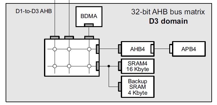

I'm using the NUCLEO-H753ZI dev board and have been testing various tx/rx reception modes using HAL routines with RTOS for all the available uarts. I have them all working well except lpuart1. When I try to receive or transmit in DMA mode I get no interrupts and no data out from the tx pin.
Am I missing something? Does this uart support DMA transfers? I see it uses BDMA instead of DMA, bot I'm not sure what the difference is.

When using lpuart1 in DMA mode I get continuous UART_DMAError() errors, tracking through the code it seems to be a transfer error:
hdma->ErrorCode = HAL_DMA_ERROR_TE;
0693W00000HnhZeQAJ.jpgI don't really see enough initialization here. CubeMX buries and obfuscates, so makes for bad examples.
Try using SRAM4 in the AHB4 / APB4 / D3 Domain for the memory buffering

I think you're probably correct in your answer and my DMA buffer should be in the SRAM4 ram. Unfortunately I have no idea how to place this in SRAM4 using CubeIDE.
Any thoughts?
Not my tools, but generally GNU/GCC would be via the linker script and __attribute__((section(".sram4"))) type construction
If it's not part of the memory visible to the linker, your could test with a simple pointer assignment.
uint8_t *Buffer4 = (uint8_t *)0x38000000; // 64KB at 0x38000000

I found this article:
https://community.st.com/s/article/FAQ-DMA-is-not-working-on-STM32H7-devices
And now have the DMA working on lpuart1. I added the following to my linker script: STM32H753ZITX_FLASH.ld
  .dma_buffer :
  	*(.dma_buffer)
  } >RAM_D3
Then added this definition in my code:
#if defined( __ICCARM__ )
  #define DMA_BUFFER \
      _Pragma("location=\".dma_buffer\"")
#else
      __attribute__((section(".dma_buffer")))
#endif
Then declared the DMA buffer as follows:
DMA_BUFFER uint8_t	dmaBuff[LPUART_RX_BUFFER];
Thanks for pointing me in the right direction!
