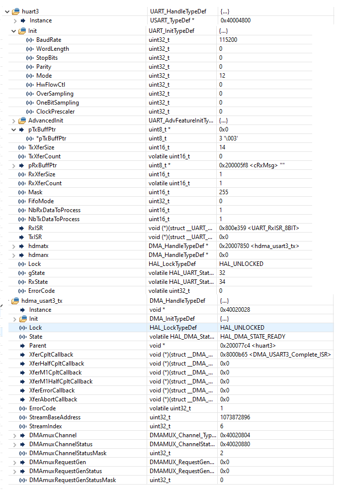

Looking at the pertinent DISCO Uart and DMA registers, it seems like the settings are all there:

Upon further investigation, after the HAL_DMA_Start_IT call (HAL_OK), the DMA2_Stream0_IRQHandler interrupt fires! But apparently , inside that HAL ISR, it has a Transmit Error which is the reason why the DISCO's DMA USART TX Complete ISR is never called.
