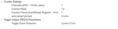

To do that I have to create a fairly fast burst of data with pulses of 0.6, 0.3  and 0.9 us.

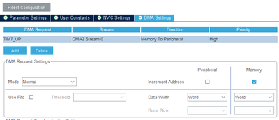

To achieve this I set timer 7 to have an update even every 100nS then I set DMA2 stream 0 in memory to peripheral configuration.
The idea is to create a buffer, with the signal timing, and then set the DMA2 to transfer that buffer to the BSRR register of the port I have connected to the leds.
And it works, It generates the pulses every 100nS and then writting to the buffer where the sets and resets are I got my signal with pretty ok timing.
The problem is that it only works once.
Since I won't be updating the leds often, I don't want to create a circular buffer and load the DMA all the time. That's why I wanted to do a normal buffer, execute it once and execute it again when I need to change the colors.

  • Why are you transferring an array of size 289 into a single register of 32 bits ? Have you enabled the source increment ? "If the increment mode is enabled, the address of the next transfer is the address of the
    previous one incremented by 1 (for bytes), 2 (for half-words) or 4 (for words) depending on
    the data width programmed in the PSIZE or MSIZE bits in the DMA_SxCR register." (extract of chapter 15 of RM0433, I advise you to read more by clicking here).

  • Once the timer has been enabled, any time the counter is cleared, either due to a reset event or due to a counter roll-over, the repetition counter is decreased. When it reaches zero, a REP interrupt or a DMA request is issued if enabled (REPIE and REPDE bits in the HRTIM_DIER register). -> Your line 9 of while loop enable CPT2IE (Capture Interrupt Enable). Are you enabling REPIE (Bit 4) and REPDE (Bit 20) ?
  • I tried clearing the interrupt flags of the DMA: -> Which flags are enabled ?
