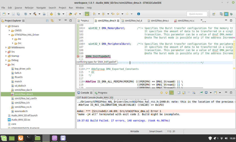

I want to catch the half transfer and the full transfer flag from DMA controller but get an error and don't understand why.
the compiler say first use in this function:
'DMA_FLAG_HTIF5' undeclared (first use in this function)
'DMA_FLAG_TCIF5' undeclared (first use in this function)
error: DMA_GetFlagStatus(DMA1_Stream5, DMA_FLAG_HTIF5);
   while(it_st == RESET) {  //warten bis Transfer Complete Flag kommt
error:   it_st = DMA_GetFlagStatus(DMA1_Stream5, DMA_FLAG_TCIF5);

waclawek.jan
This does not look as using HAL Treiber , rather, the older SPL.
I gues​s it is low level driver.
HAL ***** me up all ​all the time...
The ST documentation ​is so bad.
This Code fits the best to​ the it.
Did you know how i can make it work? Config cubemx.
The ST32F4 Series Support the LL driver i guess this is what you mean by SPL
Thank you allot. I will try the Software at the Weekend ​
Thank you so mutch. This libs are the last puzzel parts. Now the code works.
Last question.
Can HAL and SPL co-exist? Because i get an error in the "stm32f4xx_dma.h" and in the "stm32f4xx_rcc.h"
GIkar
After hours of reading documents. I know about SPL, HAL and LL. And how to solve my problem
