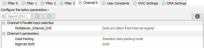

I am trying to use the DFSDM module on the Nucleo-H743ZI2 board .

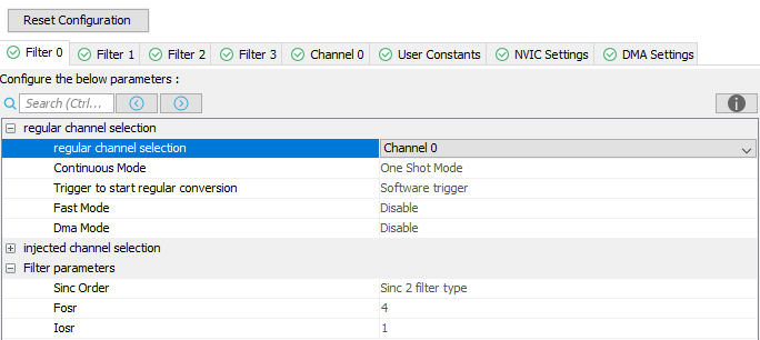

As a minimal example, i tried to use a sinc filter of 2. order with a FOSR of 4.
Channel0 is activated in the parallel mode, standard data packing mode and the setting to take data from internal register.
Additionally I mapped Filter0 to Channel0 and set it in one shot mode, software triggered, fastmode disabled, DMA disabled and setup the sinc filter parameter as mentioned before.

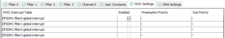

Finally enabled the global interrupt for Filter0.
